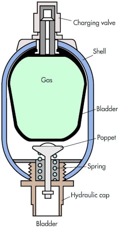

Bladder-type accumulators
Figure 1. Bladder accumulators, such as the one above, are the most common form and use a synthetic rubber, such as Nitrile, to contain the nitrogen gas precharge.
Hydropneumatic accumulators contain both a dry side (containing compressed gas, usually nitrogen) and a wet side, containing hydraulic liquid. The dry side of the accumulator is filled with the gas to a prescribed pressure, known as the precharge, based on system requirements. Because hydraulic systems perform poorly when gases the hydraulic fluid, some form of separation is required in accumulators to prevent the mixing of fluids; bladders, diaphragms, and pistons are most common.
Bladder accumulators, Figure 1, are the most common form and use a synthetic rubber, such as Nitrile, to contain the nitrogen gas precharge. The bladder is installed inside a high-pressure-capacity sealed cylinder with hemispherical caps at either end. The ideal mounting position of bladder accumulators is with the liquid port downward and the gas port upward. When a bladder accumulator is charged, its bladder fills most of the void inside the shell, and a poppet valve at the oil port prevents the bladder from extruding out the bottom. Bladder accumulators are commonly available in a wide range of sizes, from 1⁄4 to 15 gal, depending on the range the manufacturer offers.
As a bladder accumulator fills with pressurized hydraulic fluid, the nitrogen-charged bladder compresses, storing hydraulic energy equal to the volume of fluid taken in factored with the pressure of the precharge. As the fluid is discharged when downstream hydraulic pressure drops, the bladder re-expands as it pushes the oil out. The vertical mounting position will help prevent uneven wear of the bladder as the accumulator cycles, and also help avoid odd occurrences of trapped fluid or early poppet closing. That being said, a bladder accumulator will survive longer in any position, including horizontally, if fluid contamination is well-controlled.
Bladder accumulators are easily repaired, and fortunately, the major players in the accumulator game offer interchangeable rebuild kits for common accumulator sizes. The most frequently chosen bladder accumulators are bottom repairable, although top repairable are offered as well. Top-repairable accumulators are useful for installation on machines with complex plumbing or difficult mounting location, as they allow the accumulator to be repaired while remaining installed on the machine. Bottom-repairable accumulators need to be removed from the machine for repairing.

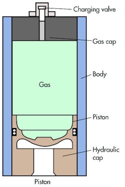

Piston accumulators, Figure 4, are similar to a rodless hydraulic cylinder capped at both ends. They include a machined steel tube with threaded caps at both ends, one cap drilled for the oil port and the other for the gas port. Some piston accumulators may be welded at one extremity, with the other side threaded for repair work. Regardless of construction, a freely sliding piston will separate the opposing fluids.
Figure 4. Piston accumulators are like a rodless hydraulic cylinder capped at both ends and include a machined steel tube with threaded caps at both ends.
Piston accumulators are generally mounted with the oil port downward and the gas port upward. However, just like bladder accumulators, they will last longer on their side if fluid conditioning is optimal. This is especially important considering that contamination could rest on the bottom of the tube of the accumulator while the piston cycles back and forth across the particles. Although strangely available in the non-repairable type, piston accumulators are quite easily repaired, especially if no uneven wear is observed on the barrel.

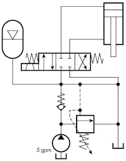

One benefit of hydraulic accumulators is to supplement pump flow, Figure 5. In some hydraulic applications, a short burst of high flow is required, such as in a punch press. To achieve the desired cycle speed in the punching operation, 20 gpm is required over 10 seconds. However, the pump output is just 5 gpm, so this velocity is not achievable on raw pump power alone. For the 50 seconds of dwell time between press functions, we can use the 5 gpm pump output to store energy in the accumulator, so the system is once again prepared for high-velocity press function. Accumulators used to supplement pump flow save the energy required to idle a larger pump, and also allow the use of a smaller pump to achieve a higher demand.
This same circuit could be used for intermittent actuator control, such as a clamp, which uses less than the 20 gpm indicated. If our clamp cylinder only requires 5 gpm once every minute for five seconds of clamp function, then the power unit could be controlled via a pressure switch plumbed downstream of the check valve. The energy in the accumulator would be enough for a few clamp functions before the capacity is depleted, which would result in the switch turning the power unit back on until the switch once again reads full pressure, and subsequently turns the unit back off. A third use of the circuit in Figure 5 is to hold pressure at an actuator. The clamp could be a maintained function with the directional valve left activated while the accumulator makes up for any leakage or decay within the components in the circuit.
Accumulators are sized for energy storage applications based on the amount of flow required to be supplemented and the difference between the maximum work pressure and the lowest system pressure. Additionally, the compression ratio of the accumulator itself must be factored into the equation, which describes the recommended highest ratio between minimum and maximum operation of the accumulator. A higher compression ratio allows for higher volume of stored fluid, and typically piston accumulators outpace their bladder companions in this regard.
The table shows an example using 10-gal bladder and piston accumulators, and their relationship with compression ratio, working pressures, and required precharge. Optimal precharge is typically 80% of minimum working pressure, because anything too high will prevent the accumulator from being fully filled, and too low will not allow much energy to be stored. The higher the difference between maximum and minimum pressure also allows for higher energy capacity, as a drop of 5000 to 1000 PSI from the accumulator will provide more volume than a drop of 5000 to 4000 PSI, for example.

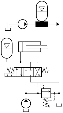

Figure 6 shows two examples to represent accumulators used for pump pulsation damping and shock absorption. Pump pulsations are the result of the pressure waves caused as gears, vanes, or pistons reach the outlet port in digital spurts rather than continuous flow. These pulsations sometimes cause annoying vibrations, rattles, and noises. An appropriately sized accumulator (typically the diaphragm type) will dampen these pulsations to “smooth out” pump flow.
Figure 6. The above illustration shows two examples that represent accumulators used for pump pulsation damping and shock absorption.
The second circuit of Figure 6 depicts an example of an accumulator used to absorb pressure spikes, such as cushion on rock-crusher rollers. Any pressure spike caused by load-induced pressure will be absorbed by the accumulator. A relief valve could be used in the same circuit, but it would direct fluid away from the cap end of the cylinder, and then would no longer return to its starting position as it would with the accumulator.
