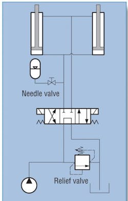

Incorporating a needle valve into a basic header positioning circuit allows a combine to use headers of varying weights.
However, what remains is to determine if that accumulator size is best for a given manufacturer’s machine. To do this, extensive field testing with different size accumulators must be conducted to determine the best fit for each header and crop to be harvested. No accumulator sizing formula exists for floating deck applications, so testing is required to make the final determination. But what if a farmer uses different headers for different crops? Another consideration comes into play because a specific accumulator precharge pressure has been determined for use with a specific header. If a farmer installs a different header, match-up problems could occur. A substantially lighter header would make the precharge pressure too high, causing stiff flotation action. Installing a heavier header would cause the flotation action to be over damped.

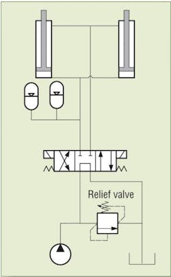

Two piston accumulators with different precharge settings eliminate having to adjust accumulator precharge pressure when installing headers of different weight.
The simplified schematic of an accumulator circuit for a typical floating header is shown above, left. The  needle valve is adjusted to change the flow rate between the circuit and accumulator to use headers with different weights.
Another solution is to incorporate two piston accumulators with different precharge settings into the circuit. This approach allows the farmer to use both headers for different crops without having to make accumulator adjustments. One accumulator will float the weight of the one header. For example, when that header is removed and replaced with a heavier one, the second accumulator becomes active in the circuit. The piston accumulator with the lighter precharge will collapse quite a bit to allow the second accumulator to take over. Bladder accumulators should not be used in dual applications because the bladder could potentially be damaged with an immediate and sudden failure.

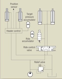

Today’s new approach to combine header flotation uses separate accumulators used for float and lift cylinders. For flotation, a ground clearance distance sensor is used with a sophisticated electronic control to automatically adjust header height during harvesting. The circuit includes a target pressure accumulator. As the header is lowered to the ground and the system is set to maintain a specific float distance, the accumulator serves as a memory device to automatically make needed adjustments if the target pressure changes.
Using separate accumulators for float and lift functions in conjunction with electronic sensors allows the hydraulic circuit to automatically adjust to changes in working conditions.
New header designs also feature a separate set of lift cylinders with a ride control accumulator that can be activated when the combine header is lifted to permit driving to the next work area. Incorporating the accumulator completely eliminates the problem of machine bouncing as it is driven down a road.
