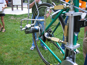

An oil actuated cylinder, driven by a cam that replaced the usual chain ring, powered California Polytechnic's entry on the difficult hilly terrain.
The University of California at Irvine fielded the only pneumatically-powered prototype. The bike used cylinders to charge 14 student-designed reservoirs, which then discharged to a pneumatic drive cylinder by way of four digitally controlled servovalves.
Murray State's recumbent entry was able to charge two hydraulic accumulators to 2500 psi, and provide a gauge reading to the operator. The accumulated pressure could be directed to the rear wheel by way of an on/off control valve.
