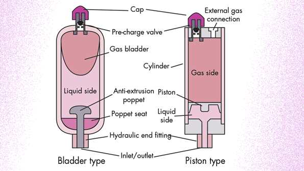

Similar to the electric capacitor, capacitance in the hydraulic circuit is both deliberate and parasitic. The deliberate hydraulic capacitor, called an accumulator, can be constructed in any one of several ways. The most common construction is gas-over-liquid, which incorporates either a bladder or piston (left and right, respectively, Fig. 18) to separate the compressible gas chamber from the liquid chamber.
Fig. 18. Most hydraulic accumulators store pressurized liquid by virtue of compressing a gas in a separated chamber. The separator is either a bladder or a piston.
It’s generally accepted that the two accumulators have essentially identical characteristics; however, research is needed in terms of comparing their performance. Like so many mechanical and hydromechanical machines, having some knowledge of their construction aids in understanding their function. The two accumulator types in Figure 18 offer a good starting point.
In the accumulator symbol (Fig. 19), there’s only the essential parts—the hydraulic inlet/outlet port, the liquid side, the gas side, and the separator. The open triangle on the gas side conveys that it’s precharged with a gas, but doesn’t indicate the type of gas nor the amount of precharge on the gas side. The symbol also doesn’t reveal the construction type. The colors are non-standard.
Fig. 19. The accumulator symbol has the essentials of a real accumulator.
Regardless of the construction type, the practical hydraulic capacitor has a gas side and a liquid side. The liquid side (hydraulic side) is typically connected to the active hydraulic circuit in its application. The gas side is usually “pumped up” to some precharge pressure with an inert gas, such as argon or nitrogen. The precharge pressure is in the same range as the operational pressure in the hydraulic system, which is in the hundreds or thousands of psi. Inert gases are used to avoid the possible combustion of hydraulic fluids that may inadvertently come into contact with the pressurized gas. Oxygen-containing precharge gases could support the combustion.
