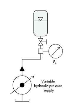

Charge retention in the accumulator
24. A variable pressure supply can be used to hydraulically charge an accumulator. A manual shutoff valve allows the charged accumulator to be removed from the circuit.
Similar charge retention occurs in accumulators. If the accumulator is charged and its hydraulic path blocked (Fig. 24), it can be removed from its charging circuit. Thus, energy stored in the compressed gas will be retained. That energy can be used elsewhere at some other time.
