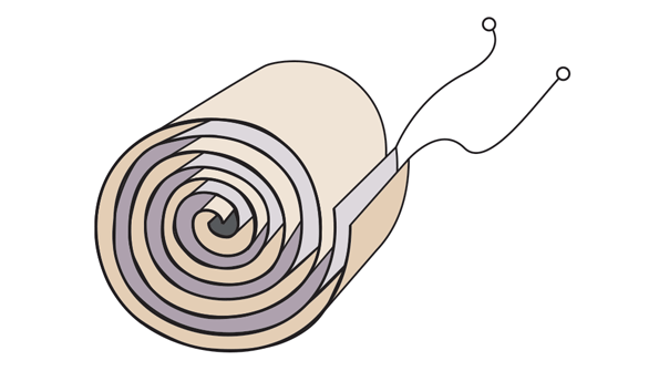

Capacitors are specified by their capacitance, most often in microfarads or picofarads for smaller sizes. The devices tend to be limited by working voltage—the maximum voltage that can be safely applied. Higher voltages could damage the separator dielectric. As the capacitance increases, maximum voltage often drops because the increased capacitance can be achieved by reducing the dielectric’s thickness.
