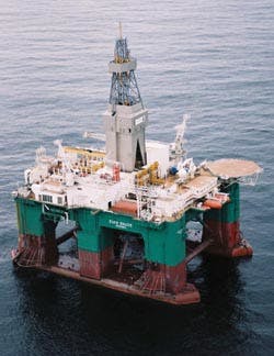

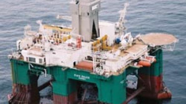

The 1960s saw the predecessors to modern day floating drilling vessels. These vessels, unlike jack-up rigs, must have control systems to combat the effects of the ocean: waves, tides, currents, and winds. The motion compensator system is one such system, which uses hydraulics to compensate for wave-induced vertical motion of the drilling structure.
Motion compensator system
Today, drill ships and semi-submersible drilling platforms use motion compensator systems to allow drilling in water depths to 10,000 ft., while experiencing waves as high as 40 ft. A simplified offshore drilling system is represented in Fig. 2. The motion compensator is made up of:
