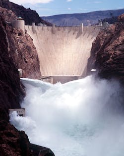

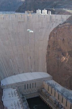

Hoover Dam is often called one of the modern wonders of the world. Standing more than 700 ft tall and containing more than 3.25-million cubic yards of concrete, the magnificent structure spans the Colorado River between Nevada and Arizona, forming the 247-square-mile Lake Mead reservoir behind it.
Hoover Dam generates more than 4 billion kW-hr of electricity every year by routing water from Lake Mead through a series of hydroelectric turbines. When a load rejection occurs, hydropneumatic accumulators help open relief valves to prevent damage to a turbine.

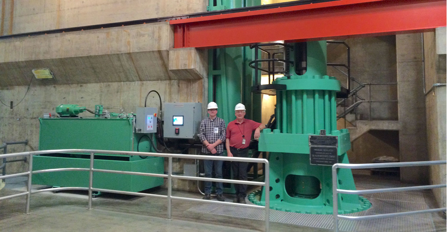

Shown here is the work site after project completion. At left is the hydraulic power unit; in center, behind men, is a bank of accumulators; at right is the top of the top of a pressure relief valve assembly.
