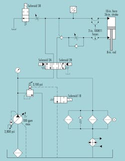

A 100-ton press was designed and installed to close and form large pieces of ¼- to ½-in. thick sheet metal.
A 100-ton press was designed and installed to close and form large pieces of ¼- to ½-in. thick sheet metal. To extend the press, solenoids 1B, 2A, and 3B (see accompanying schematic) would energize to extend the ram engage the metal while decompression valve 3B and solenoid 2A would de-energize. When pressure at the transducer dropped below 2,000 psi, solenoid 2B would energize to retract the ram.
The flow control was only used to create enough backpressure to keep the pilot-operated check valve open while the ram extended. The pressure-compensated pump had a displacement stroke adjustment to control the ram speed that was needed from time to time.
A problem with the rod-end hose blowing off started when the speed of the ram was reduced to process thinner plates. The hose would fail after several hundred plates were run.
Any idea what was causing the problem?
