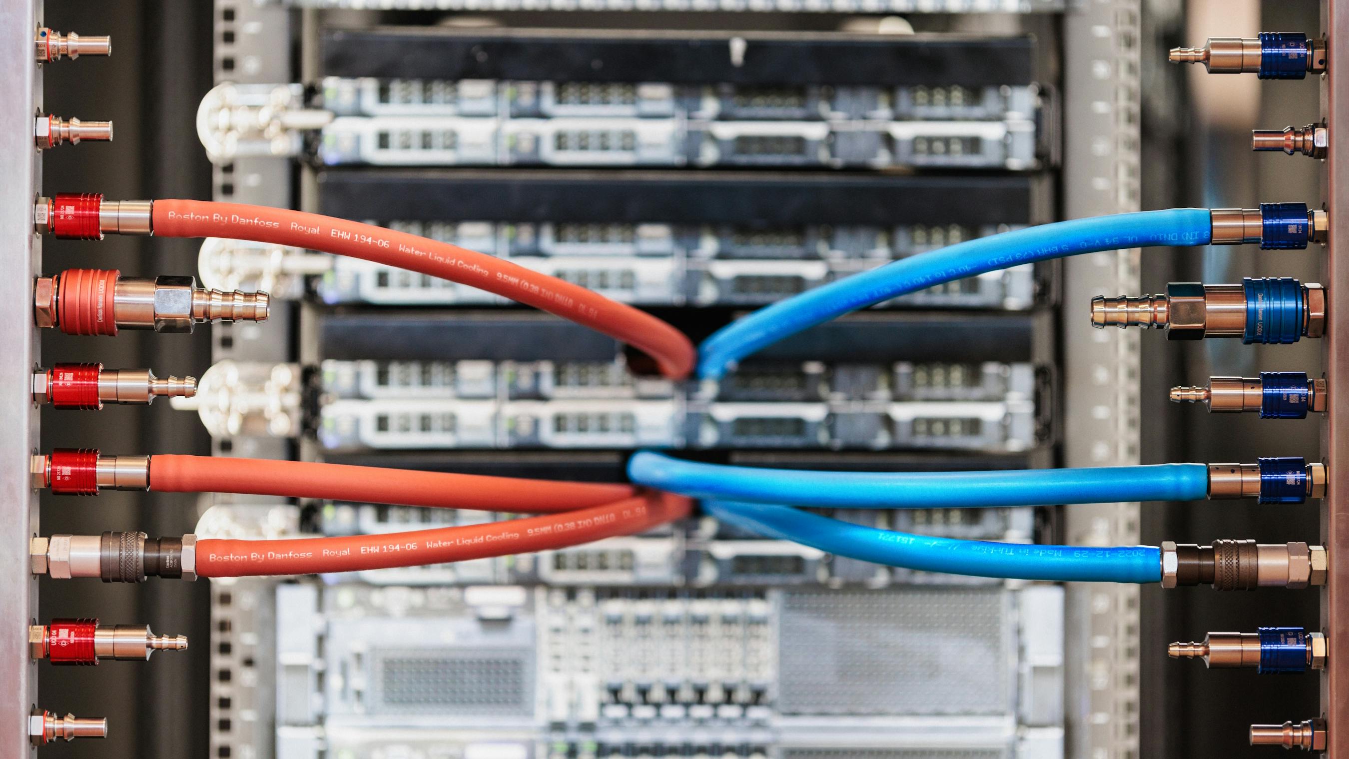

Ensuring efficient liquid flow is necessary as well. To do so, it is important to achieve high flow and low pressure drop across the quick disconnects and couplings, he said. This provides assurance that the cooling system’s pump operates at its most efficient. “It’s all about minimizing leakage near the electronics and maximizing the efficiency of the whole process,” he said.

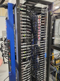

Space constraints also need to be considered when developing products for data centers. There is often less installation space available in data centers, necessitating use of compact and easy-to-install components. Hydraulic hoses with tight bend radiuses are especially beneficial to ease their routing in these applications.
This was one of the many aspects that factored into the design of Gates’ Data Master data center cooling hose released in late 2024. Per Haen, it offers flexibility for easy routing and compactness to fit within tight server rack layouts. In early 2025, the company introduced another data center cooling hose to its line, the Data Master MegaFlex, which also offers flexibility for tight installation spaces while also delivering higher flow capacity.
Other important design features for the Gates data center hoses include the use of specialty-compounded materials to maintain system cleanliness as well as flame resistance.
