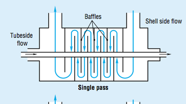

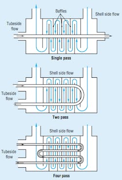

Heat-transfer mechanisms
Fig. 1. One-, two-, and four-pass heat exchangers increase cooling rate, promote turbulence, and destroy the insulating film layer that exists with laminar fluid flow. Baffle plates speed oil flow through the shell side for the same reason.
The heat transfer coefficient, U, is composed of several mechanisms. The first is the convective heat transfer from the hot fluid to the wall separating it from the cold fluid or air. This can be called the hot fluid thermal resistance, which depends primarily on physical and thermal fluid properties. Turbulent flow and high velocity improve heat the transfer rate.
The second heat transfer mechanism is thermal conductance through the tube wall. Most heat exchanger tubes are built from copper or aluminum alloys or similar materials that exhibit high thermal conductivity.
The third mechanism is the convection of heat from the tube wall to the cooler fluid in the tube. This mechanism acts in much the same manner as the hot fluid thermal resistance. Use of multi-pass flow patterns takes advantage of the fluid velocity and turbulence for increased U values.
Other conditions that influence heat transfer rates are fouling factors that may occur on both sides of the tubes over a period of time. When a flowing fluid system deposits material or scale on boundary walls, they become fouled. This layer of scale:
  • acts as an insulator
  • increases effective fluid-film thickness, and
  • reduces fluid velocity distribution near the tube wall.
As the scale thickens, heat transfer rate decreases accordingly. Mechanical or chemical cleaning, or both, may be necessary to remove the scale when excessive deposits degrade heat exchanger efficiency.
Tube-pass configurations
Heat exchangers are available in 1-, 2-, and 4-pass configurations, Figure 1. These multiple passes result from dividers in the bonnets that mate with segmenting bars on the tube sheets to initially force the cooling medium (water) through only a fraction of the tubes. This causes the water to flow one, two, or four times the length of the heat exchanger before it leaves the outlet.
