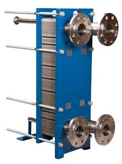

PF Series heat exchangers are a compact, serviceable design and flexible cost saving alternative. The unique designs produce high heat-transfer coefficients for a given application. Large heat-exchanging surfaces in a space-saving frame. Double sealing design prevents the possibility of mixing the two process fluids. Readily expanded for greater capacities. Low-temperature approaches/differences. Capable of handling large volumetric flows with low pressure drops.TTP, an API Heat Transfer company

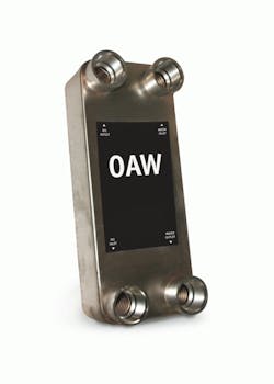

Alfa Laval’s DOC Series brazed-plate heat exchanger offers high efficiency for hydraulic oil cooling. The unit is easy to install, and the connection block decreases stress on the standard connection by 80%. With a variety of connection ports including SAE and NPT, the DOC range provides high heat transfer while allowing for low-pressure drops — resulting in an efficient hydraulic system.Alfa Laval Thermal

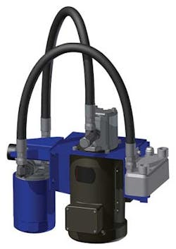

The MFC3 is a compact off-line filtration/cooling package that provides numerous mounting and configuration options. The design allows for multiple selections of ac motors, pumps, filter elements, and auxiliary components. The modular design concept permits field upgrades concerning oil flow, filtration, or configuration with minimal labor and cost.Bosch Rexroth
