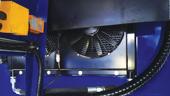

Mobile equipment presents special challenges for removing heat from hydraulic systems. As shown here, heat exchangers must often be placed in inaccessible areas with limited space. (Photo courtesy of Thermal Transfer Products/API Heat Transfer)

That leaves us with air-to-oil heat exchangers. You can’t rely on ambient air alone to provide enough heat transfer to cool the hydraulic oil in a heat exchanger. Instead, a fan is needed to force ambient air through the heat exchanger. However, air temperature can vary dramatically with mobile equipment. A single machine may operate in below-freezing temperatures much of the time, and in temperatures exceeding 100° F at other times. Loads can also vary widely because equipment may require little cooling while running in standby mode for long periods. However, that same machine may require maximum cooling while operating at full load.
This means an air-to-oil heat exchanger should be selected to provide maximum air flow for the severest operating conditions, but operate more efficiently by providing less air flow when the hydraulic system requires less cooling. The traditional method to move air through a heat exchanger was to use an engine-driven fan. However, motor-driven fans have proven to provide more effective and more energy-efficient cooling than a fan running at engine speed. The fan operates at full speed when maximum cooling is needed, and they run at slower speeds—or not at all—when less cooling is called for. They can even rotate in reserve to help clean the heat exchanger by blowing debris out.

You can use hydraulic oil to power a hydraulic motor and rotate a fan. If hydraulic flow is readily available, or the system allows enough extra power to produce this flow without hindering the machine’s operation, this can be a great option. The efficiency of the hydraulic motor should be considered against other options—an electric motor for instance. The advantage of hydraulics is that the flow and pressure needed to develop the necessary power (fan speed) in these cooling systems is already available on the machine.
Air-to-oil heat exchangers use a fan to blow cool air between fins, which transfer heat from hydraulic oil in tubes to the cool air. (Photo courtesy of Thermal Transfer Products/API Heat Transfer)
The other choice is to use an electric motor to spin a fan. These systems are usually on smaller mobile systems, but larger machines may use multiple electric fans, which can run at different speeds or not at all, depending on cooling demand. A consideration with electric fan drives is that the machine’s electrical system must have the capacity to drive the electric motor or motors. The controls available for the electric fan are inexpensive, and the fan speed can be easily altered. This can be an easy-to-install system can run very efficiently.
