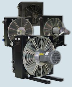

When no water source is available, or the choice is to remove heat from the oil via the surrounding air, an air oil cooler is used to convect heat (Fig. 1). Hot oil passes through the tubes of these heat exchangers, and turbulators help break up laminar flow to promote efficient heat transfer from the fluid to the tube wall. The tube metals also have high thermal conductivity.
1. Air Oil Coolers use surrounding air to remove excess heat. Specially designed fins promote turbulent air flow to improve heat transfer capability.
There are two types of construction for the cores utilized on air oil coolers Tube-and-fin construction consists of round or oval tubes and an array of external fins. This design is lightweight and offers low pressure drop. The tubes are typically welded aluminum, and they have thin walls, making them more susceptible to damage from extreme pressures and any external debris that could be encountered in the application.
Bar-and-plate construction (Fig. 2) is characterized by its compact and efficient design. It provides more cooling per cubic inch than tube-and-fin units. The basic construction consists of finned chambers separated by flat plates which route fluids through alternating hot and cold passages. This design results in a type of honeycomb structure that offers high resistance to vibration and shock. The core usually is fabricated from aluminum, but regardless of the materials of construction, the core is furnace brazed in a controlled atmosphere or high vacuum.
2. Bar-and-plate heat exchangers consist of finned chambers separated by flat plates that route fluid through alternating hot and cold passages. Heat is transferred via fins in the passageways, through the separator plate, and into the cold fluids via fin once again.
Another reason for using bar-and-plate is that design flexibility is much greater than the tube-and-fin type. Finned passage sizes are easily varied by changing fin type, height, and density. A bar-and-plate heat exchanger size can be customized to fit a particular envelop. Heat exchanger manufacturers offer many different motor configurations, voltages, and displacements, depending on the application requirements. Mobile equipment uses either hydraulic-driven or dc electric fan motors. Industrial equipment and HPUs have ac electric motors connected to the fans and pull air through the cooler core.
