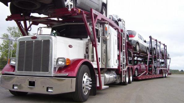

Hydraulics moves the ramps and platforms that allow a single carrier to hold multiple cars. Naturally, heavy loads are involved, and the hose must tolerate brutal over-the-road conditions. Typically, car carriers have relied on SAE 100R1 hydraulic hose for pressures to 2250 psi for 3⁄8-in. hose (to 2000 psi for 1⁄2-in. hose) and SAE 100R2 for pressures to 4000 psi for 3⁄8-in. hose (3500 for 1⁄2-in. hose). However, the pressure rating for one manufacturer’s proprietary hydraulic hose is 2750 psi for the  3⁄8-in. size and 2500 psi for 1⁄2 in.

Another consideration is durability. Car carriers must operate under a wide variation of environments. Hose may be subjected to temperatures down to –40° when transporting cars during the frigid winters of Minnesota, or be baked by temperatures of 120° F or higher — plus ultraviolet radiation — when subjected to a scorching Arizona summer. Add to this sand, dirt, road grime, ice, snow, and hail bombarding the hose at highway speeds, and you realize how tough a hose cover must be. Standard testing for hose-to-hose abrasion has revealed that 100R1 hose undergoes roughly 312,000 cycles before replacement becomes necessary. Under the same tests the proprietary hose survived about four times the cycles before the same wear was observed.
