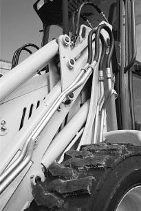

Hybrid tube/hose assemblies combine the benefits of hose and of rigid tubing for optimum performance.
Components on many types of hydraulic equipment are connected by rigid tubing. Being rigid, however, tubing can transmit vibration from one component to another throughout an assembly. Increasingly, designers of hydraulic systems are integrating bent tubes and hoses into hybrid bent assemblies. These assemblies provide the weight and bend advantages of bent tube with the flexibility and vibration dampening characteristics of hose.

At one time, equipment manufacturers specified hose primarily when dynamic bending of hydraulic lines was necessary. If the hydraulic line didn't need to bend, metal tubing was almost always preferred. Today, designers of mobile equipment in particular are learning to optimize designs by specifying hybrid steel-tube/hose assemblies - especially in applications where vibration is severe. A feasible alternative to port-to-port steel tube assemblies is to connect steel tubing to a port, then run a length of hose to the other component. Some designers even replace steel tubing altogether with a single hose assembly when application parameters permit.
The interface between hose and rigid tubing is vulnerable to leakage caused by stress and strain induced by vibration, shock impulses, and differential expansion. To prevent leakage, hoses should be long enough to always remain slack, but be short enough to prevent rubbing against adjacent surfaces.
An example of how hybrid steel-tube/hose assemblies work together is exhibited on agricultural equipment that include 60-ft long boom attachments. In the past, manufacturers have preferred to use bent tube assemblies on these attachments in order to minimize weight and prolong the life of the tool bar. However, manufacturers today recognize that these attachments generate vibration, which is a major factor leading to system failure. Their solution to this problem has been to use primarily hose assemblies where the structure can tolerate the higher weight and a bent tube/hose combination where light weight is more critical.
