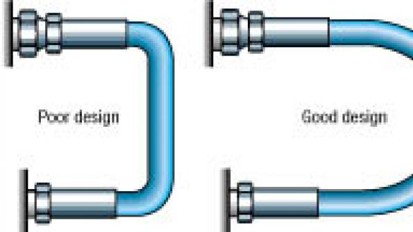

Application basics
Most manufacturers offer hose that can be bent to a tighter radius than that published in industry standards. Still, bending hose to a smaller radius than recommended should be avoided to avoid shortening service life. Therefore, route hose in a manner that provides ample bend radius.
