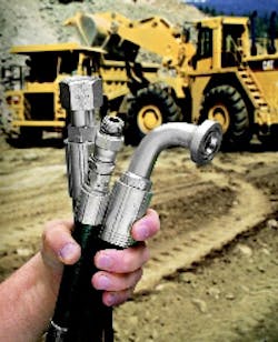

Choose the right connections
The couplingtohose interface must be compatible with the hose that is selected. Follow the hose manufacturer's coupling recommendations only. The proper mating thread end must be selected to ensure a leak-free seal can be made to mating components.
Coupling selection can be more complicated if the end connection undergoes a high degree of motion, vibration, or both. Split flange couplings — or other couplings that use an O-ring for sealing — perform well under vibration. Couplings that use O-rings also are preferred in applications that undergo extreme temperature fluctuations.
Threadless connectors are becoming an attractive zero-leak alternative to conventional threaded fittings commonly used in hydraulic systems. The male and female halves simply push together — without wrenches or special assembly tools — to form a leak-free connection.
Several manufacturers have introducedthreadless connectors that yield the performance of Oring seals, but eliminate the cost of O-ring installation for hydraulic systems with working pressures to 6000 psi. As with JIC fittings, these connectors also provide a metalto-metal seal, but they don't have to be tightened to a specific torque.
Threadless connectors are used at the hydraulic port or manifold on steering units, valve blocks, pumps and motors. They offer several key benefits to equipment manufacturers:
  • leak-proof connections that reduce the cost of warranty claims and fluid leaks from equipment used in the environmentally sensitive applications
  • easier, quicker connections that reduce assembly costs
  • tactile feedback and visual confirmation that the connection has been made
  • assurance that connections cannot be accidentally made with other threadless couplings
  • easy serviceability, and
  • easy replacement in the field with traditional and widely available threaded connectors.
Some types of threadless connectors eliminate the need for adapters, which not only saves space, but somewhat offsets the higher cost normally associated with these types of hose end fittings.
The biggest advantage of threadless connectors is the reduced time and expense needed to install hydraulic hose and tubing assemblies and a greater accessibility for subsequent maintenance.
Installations with conventional threaded fittings can take several minutes or even hours, and they are subject to leaks because of tightening inconsistencies and other variables. On the other hand, threadless connectors allow even confined, difficult-to-reach connections be completed in minutes.
Instead of screwing on the threaded connector and tightening it with a wrench, threadless connecting halves — the male end and the adapter — simply push together to form a leak-free connection. A snap ring positively engages the male and female halves, without any assembly tools, although some designs do require a special tool for removal.
Avoid using couplings and hoses from different manufacturers interchangeably. This is because different manufacturers use different materials, which can result in a variety of tube styles. SAE allows a wide range of materials. An improperly matched or coupled hose will likely fail, causing downtime and injury. Therefore it is important to follow only the crimp and assembly recommendations of the manufacturer of the products being used.
