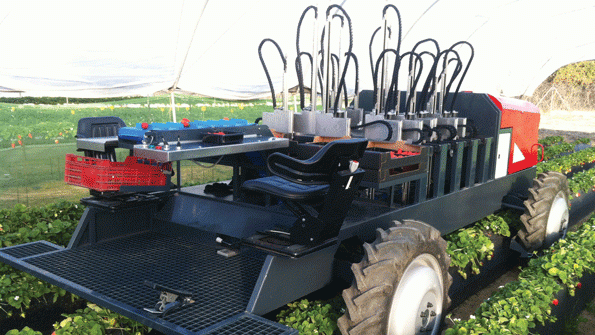

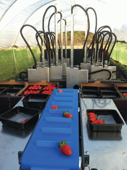

This strawberry harvesting machine uses multiple long hose assemblies that follow vertical strokes in picking ripe fruit. Hose carriers are essential in guiding hoses through long linear movements to keep them from getting snagged or tangled. (Photo courtesy of igus inc.)
