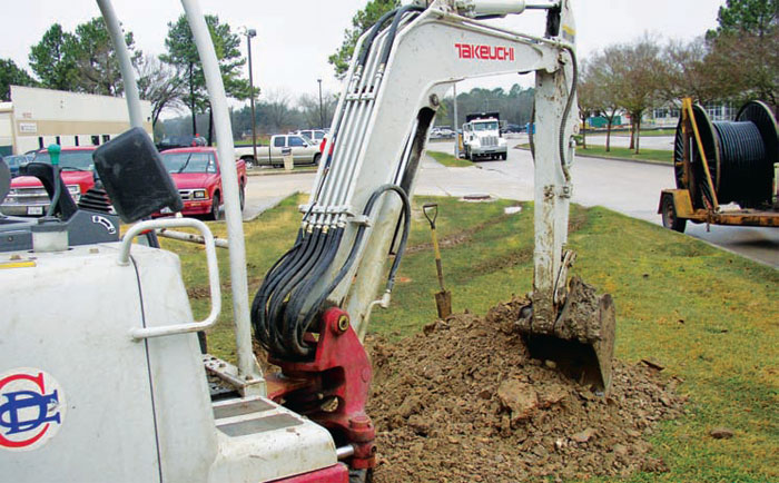

• Minimum bend radius. This refers to the tightest bend a hose can tolerate, per manufacturer’s recommendation. Using a smaller radius than recommended will likely harm the reinforcement and reduce hose life.
• Unusual mechanical loads. External forces can shorten hose life. Avoid excessive flexing, kinking, tensile and side loads, and severe vibrations.
• Routing. Though hose is flexible, avoid bending in more than one plane if at all possible. Twisting hose to even a small degree can substantially reduce life. Swivel-type fittings or adaptors may be required to prevent twisting. And when multiple lengths of hose lie next to each other and have considerable relative movements, carriers keep them neatly arranged and prevent tangling or rubbing.
