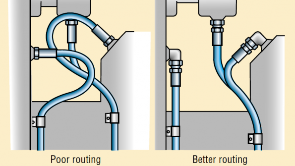

Figure 8. Lack of planning produces cluttered hose routing, far left, that complicates maintenance and can even reduce hose life. Well-thought-out routing and choice of end fitting configurations, near left, makes assemblies that are more reliable and easier to maintain and troubleshoot.
However, heat from an internal source — the hydraulic fluid itself — also can reduce the service life of the hose. Pumping hydraulic fluid at a temperature of only about 18° F over the maximum recommended temperature for a hose can cut its expected life in half. What makes this problem even more serious is that machine operators often are unaware that fluid temperatures may exceed manufacturers recommendations - especially if the high temperatures occur only intermittently.
Finally, strive for neat appearance when routing hoses, Figure 8. This not only prevents tangling, twisting, and rubbing together (which can cause abrasive wear), but aids maintenance by making it easy to remove and re-install hose assemblies and trace circuit routing.
