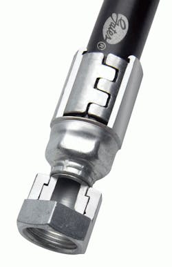

Connecting a 3,000-psi hose with a 3,000-psi coupling doesn’t necessarily mean you have a 3,000-psi hose assembly. The hose-coupling interface is often overlooked when it comes to hose performance. This interface is the science of controlling how the coupling is connected to the hose and the study of their interaction. Unless the hose and coupling are specifically designed for each other, the assembly may have a lower pressure rating, shorter life, or even worse, a catastrophic failure.
Figure 2. This sectional view of a hose-coupling interface shows how components designed to be used with each other form a precise assembly that will achieve a long, leak-free service life.
Factors affecting the hose-coupling interface include stem and ferrule design, hose reinforcement, hose tube material, and the two most important factors — the outside diameter of the hose (hose OD) and the outside diameter of a crimped coupling (crimp OD) — all variable factors. High-quality manufacturing processes can reduce hose OD variance, but some variation will still occur. Crimp OD will also show deviation from an exact dimension due to the minimal variation in coupling and ferrule manufacturing tolerances, crimper performance, and other external factors.
