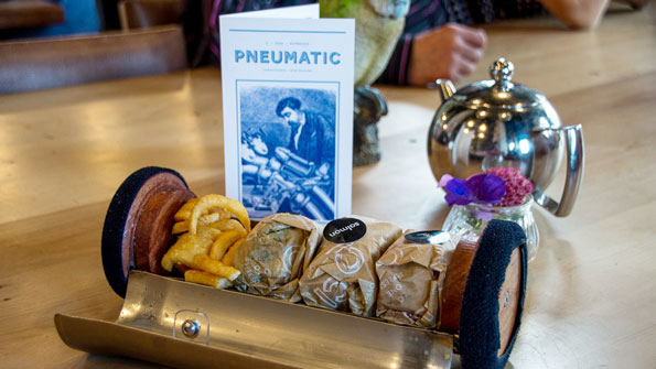

The C1 Café has a special menu containing all items that can be delivered via pneumatics. This salmon burger combo was in the kitchen just seconds before being delivered to the customer’s table.

At first, the tubes were used by wait staff to send orders back to the kitchen as a trial to see if this could work. Following that success, the next step was to install heavy-duty tubing to handle the weight of burgers. C1 Café’s customers choose from a “Pneumatic Menu,” which includes the signature dish, three sliders, and an option of fries. A kitchen worker places the order into a stainless-steel capsule, loads it into the appropriate tube, and the order is sent flying through the tube system at 87 mph to a station near the diner’s table. To prevent any damage to the food, a custom air-brake system slows the canister down before delivery.
