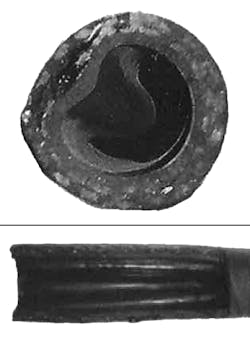

Problem 14: Restricted Hose Bore
The hose bore appears restricted. The tube may be torn or broken loose from the reinforcement and piled up at the end of the assembly, resulting in a reduced flow or blockage. The outside of the hose may show signs of being flattened.
Cause: There was a vacuum failure. The hose may have been kinked, flattened, or bent too sharply.
Solution: Replace hose with one rated for the vacuum application.
