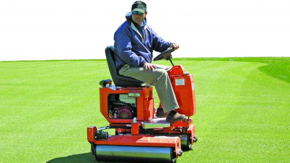

The Greenbrier uses Eaton’s LifeSense hydraulic hose on greens rollers to continuously monitor the condition of hose electronically.
The Greenbrier chose to use Eaton’s hard-wired LifeSense system. Eaton also offers a wireless version, which can even send alerts to smart phones. The simple hard-wired system has as red light that blinks if a hose sensor connector becomes loose, and the light illuminates constantly if a failure is detected, thereby minimizing false alarms.
