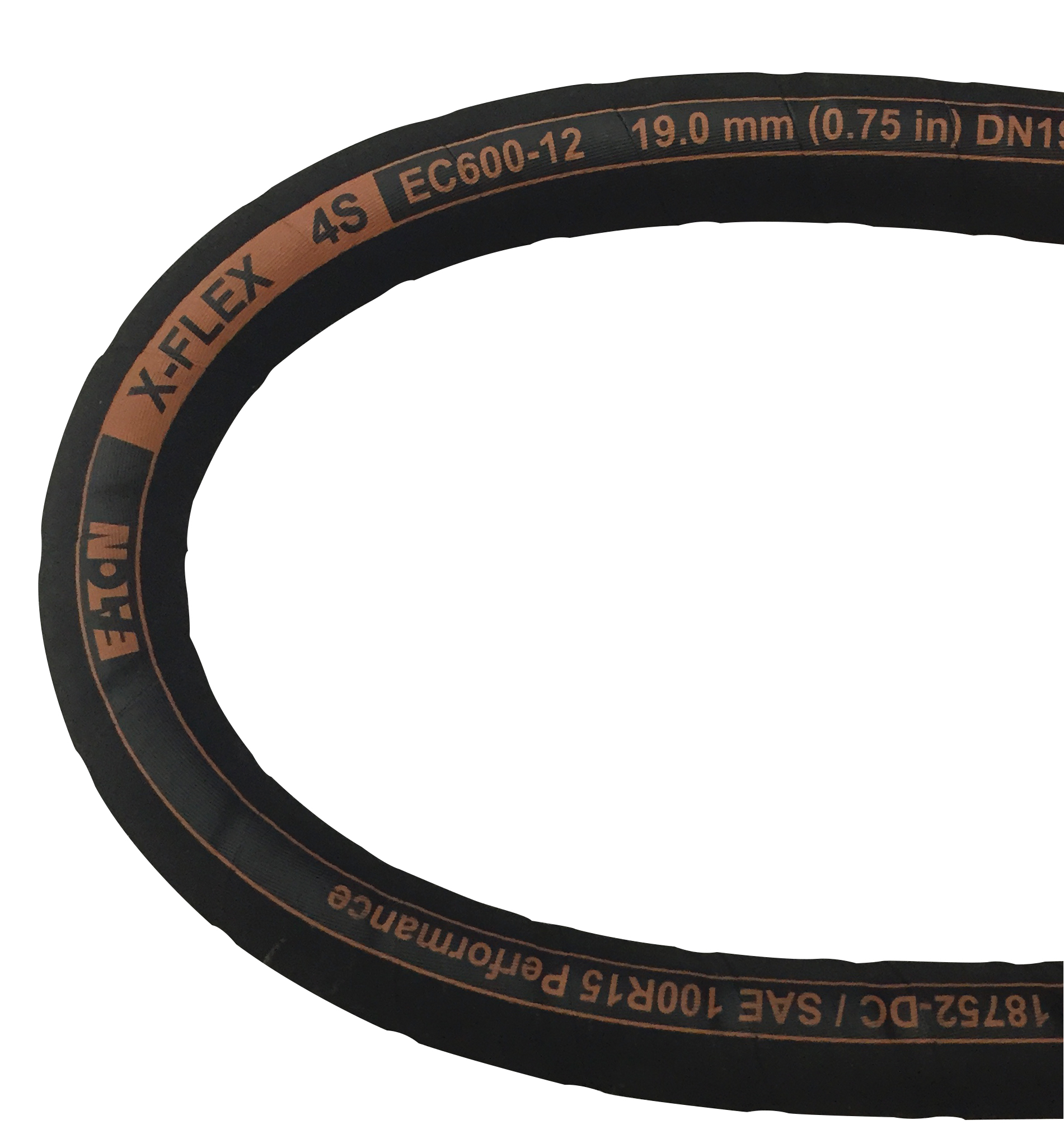

Eaton's EC600 X-FLEX hose
Designed for high-pressure applications, Eaton Corp. will be showcasing its EC600 X-FLEX spiral hose at IFPE Booth S80230. This hose features aflexible design for easy handling during installation, particularly in small spaces. At 50% of the Society of Automotive Engineers’ SAE 100R15 bend radius, the hose’s abrasion-resistant cover improves its assembly life, uptime, and operating costs. It can withstand more than one million impulse cycles at pressures as high as 6,100 psi, making it suitable for high-impulse applications like construction, mining, and industrial equipment. A limited number of free sample kits are available to demonstrate flexibility. Offered with four- and six-spiral wire construction, it is operable at temperatures from -40°C to +121°C. with no fluid leakage between hose and fitting when the machine shuts down and the system cools.

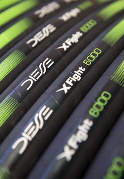

At Booth S82301, Diesse Rubber Hoses SpA presents itsX FIGHT 500-7250 PSI and X FIGHT 4000-5000-6000 PSI hoses. These are homologated over 1 million cycles for better performance across heavy-duty applications. Their low bend radius makes them extremely flexible and easy to handle during assembling. Products also include a complete range of BOP hoses that are homologated according to LLR and API 16D specification. WATER WAVE â -in. and ½-in. is also available for industrial cleaning.
