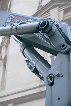

Contamination is estimated by hydraulic experts to cause 65% to 90% of all hydraulic system failures, making it a major cause for concern for fluid power engineers. And although filters have improved, oil can still become contaminated and cut short the life of hydraulic equipment.

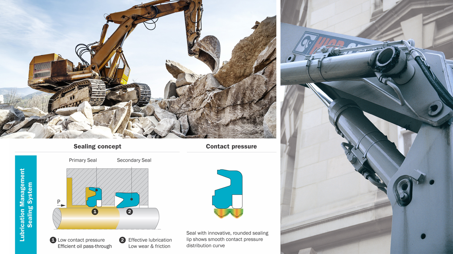

Hydraulic seals primarily prevent leaks. They can also help limit internal contamination through Lubrication Management, an approach that uses specially engineered seals to regulate lubrication between primary and secondary seals. This reduces heat generation and minimizes wear, increasing the components’ service lives. Less heat also lets hydraulic fluid last longer and not degrade, while reduced wear lowers the amount of particulates generated from the seals and their counter surfaces.

Static seals are used throughout hydraulic systems and are often the last line of defense against internal leaks and outside debris getting into the hydraulics. They are typically located near threaded components. Therefore, it’s critical to avoid damaging them during installation. In higher pressure applications, hardware can sometimes balloon, increasing the space between metal components. In these situations, it’s important to specify the proper squeeze to ensure the seal retains enough sealing force to function.
