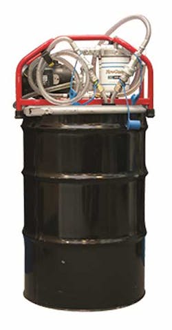

4. Filter all new fluids. New fluids are not clean. It has become common practice to bypass this initial filtering to cut costs. But the price of high-quality, cost-efficient filtration of new fluids is substantially less than the cost of letting contaminated oil into a system.
When it’s necessary to add or replace fluid, the new fluid should be filtered to meet the minimal threshold of the company’s established ISO standards, if not to one scale number above those target codes.
If you outsource this responsibility, talk to the service provider about the costs of cleaning new oil to meet the ISO standards. Then conduct a joint review of their filtration equipment to assess its cost effectiveness following the guidelines in step 2.

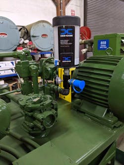

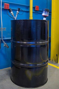

5. Seal all reservoirs and bulk tanks. The air is filled with contaminants smaller than 40 microns and invisible to humans. If reservoirs and tanks aren’t completely sealed, these contaminants can easily get into the fluid and hydraulic system and wreak havoc. If the reservoir breather is never checked or replaced, it directly degrades fluid cleanliness, which in turn lowers fluid performance and raises operating costs.
