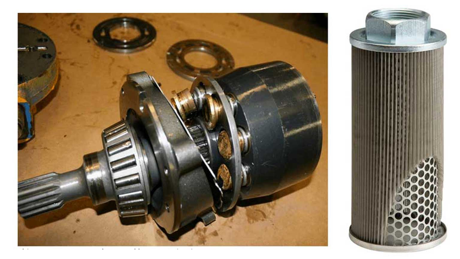

To get the best performance out of a hydraulic system, it is essential that it have proper filtration. Choosing the right type of filter and sizing it properly could be the difference between a smooth running, long lasting hydraulic subsystem and one that performs poorly and is often down for maintenance.
But selecting the proper filter is not a simple task for designers or operators who must replace old or damaged filters. Even if a maintenance team is replacing a damaged filter with one just like it, the team should ensure it is the right filter for getting the job done efficiently and effectively.

What type of pump is being used? Is it a piston, gear, vane or other type of pump? This is important to know when installing a new or replacement suction strainer. Suction strainers keep contaminants out of the pump, the most important component in a hydraulic subsystem. Different types of pumps sometimes require more protection. The chart below provides general guidelines for adequately protecting hydraulic pumps.
What mesh or micron should be used? To completely size a filter, knowing the filtration level is critical to efficiency. Suction lines should be no finer than 200 mesh (74 micron). Having filtration that is too fine on the suction side can cause pump cavitation. (See the table above for guidelines on filter mesh.)
