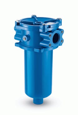

Return filters may be the best choice if the pump is sensitive to contamination. Usually, they are the last component through which fluid passes before entering the reservoir. Thus, they capture wear debris from all working components and any particles that enter through worn cylinder rod seals before such contaminant can enter the reservoir and be pumped back into the system. Because this filter is located immediately upstream from the reservoir, its pressure rating and cost can be relatively low.
Retracting some cylinders with large diameter rods may result in flow intensification. This high return-line flow rate may open the filter bypass valve, letting unfiltered fluid to pass downstream.

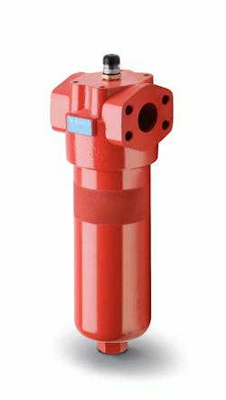

Pressure filters are located downstream from the pump. They handle system pressure and are sized for a specific flow rate in the pressure line where they are located. Pressure filters are especially suited for protecting sensitive components, such as servovalves, directly downstream from the filter. Because pressure filters are located just downstream from the pump, they help protect the system from pump-generated contamination.

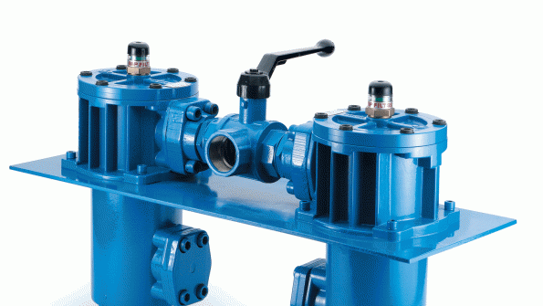

Duplex filters may include pressure and return filters. They provide continuous filtration, with two or more filter chambers and necessary valves to allow for uninterrupted operation. When one filter element needs to be serviced, the duplex valve is shifted, diverting flow to the opposite filter chamber. The dirty element can be changed, while flow continues to pass through the cleaner element. The duplex valve typically is an open cross-over type to prevent flow blockage.

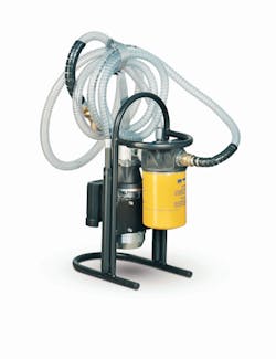

This popular filtration arrangement—also called recirculating, kidney loop, or auxiliary filtration—is totally independent of a machine’s main hydraulic system, so it is attractive as a retrofit project. An off-line filtration circuit includes its own pump and electric motor, a filter, and required connecting hardware. These components are installed off-line as a small subsystem separate from the working lines, or they may be included in a fluid-cooling loop. Fluid is pumped continuously out of reservoir, through the off-line filter, and back to reservoir. A rule of thumb: the off-line pump should be sized to flow a minimum of 10% of the main reservoir volume.
With its polishing effect, off-line filtration is able to maintain fluid at a constant contamination level. As with a return line filter, the off-line loop is suited to maintain overall system cleanliness; it does not protect specific components. An off-line filtration loop is relatively easy to retrofit on an existing system that has inadequate filtration. Also, it can be serviced without shutting down the main system.
