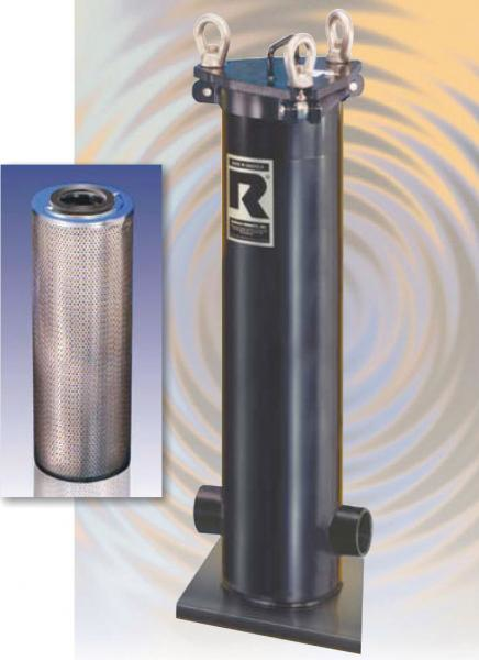

Model 7180 hydraulic lube-oil filter is designed for use with 718 and 736 style filter cartridges. They are rated for flows to 50 and 100 gpm, respectively. Housings are rated to 150 psi and incorporate an eyenut cover that is easily removed for quick cartridge change-out. Side-in/side-out piping arrangement is available with 1, 11⁄2, and 2 in. NPT connections. They are rated to 1 µ absolute and 100 µ nominal. Cartridges have a 95% filtration rating at 1, 5, 10, 20 and 30 µm.
Model 7180 hydraulic lube-oil filter is designed for use with 718 and 736 style filter cartridges. They are rated for flows to 50 and 100 gpm, respectively. Housings are rated to 150 psi and incorporate an eyenut cover that is easily removed for quick cartridge change-out. Side-in/side-out piping arrangement is available with 1, 11⁄2, and 2 in. NPT connections. They are rated to 1 µ absolute and 100 µ nominal. Cartridges have a 95% filtration rating at 1, 5, 10, 20 and 30 µm. They are made from Phenolic impregnated cellulose and operate in temperatures to 250°F (121°C) with a change-out of  ∆P of 25 psid (1.7 bar). Housings are electropolished for a smooth, easy to clean surface.
