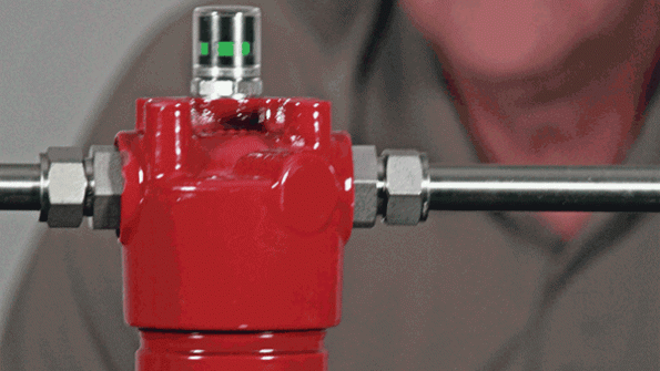

Clogging indicators are warning devices that signal visually or electrically that a filter element is filled with contaminants and should be changed or cleaned. These indicators activate when the flow of fluid causes a pressure drop (∆P) across the filter element that exceeds a predetermined setpoint. In filters that incorporate bypass valves, contaminated fluid will flow past the element if the operator does not respond to the indicator’s signal within a reasonable time. In non-bypass filters, if the indicator warning is not heeded, the pressure across the filter will build up to the point where system performance is degraded, the element fails, or the system relief valve opens.
The indicator is set to trip well before the element becomes fully clogged — usually at about 15 psid (1 bar) lower than the bypass pressure. This gives the operator enough time to take corrective action. The indicator warning may be a visual signal at the filter site (pop-up button, light, etc.) or some form of signal at a remote location (an indicator light, audible alarm, etc.). In the most critical applications, the signal from the indicator may be used to shut down the system, which would call for immediate service from personnel.

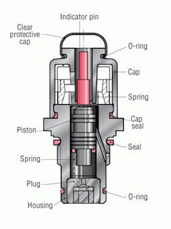

Cutaway view shows major components of a Type 1 ∆P indicator, which provides a visual signal of filter clogging.

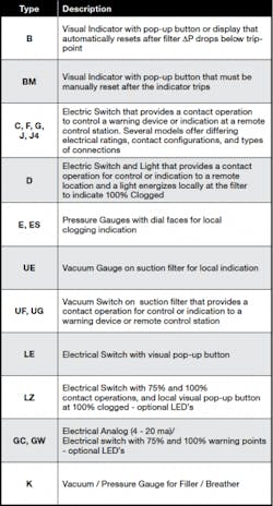

Filter assemblies may be ordered with or without indicators. When ordered with an indicator, Hydac’s assembly model code includes a letter symbol for the indicator, such as B, C, or D.  Type B or BM visual indicators are suitable when only a local warning is required. To signal a remote warning device, control panel, or PLC, an electric switch should be specified. Various kinds of switches are available to provide a range of electrical configurations, contact ratings, and connections. Our Type D indicator incorporates a switch and built-in light for both local and remote warning signals.
Key features
Automatic or manual reset— All Hydac indicators with electric switches reset automatically to their original position when the pressure across the filter drops below trip pressure. This is true for our Type B visual indicator. However, on the type BM visual indicator with manual reset, the signal arm extends once the trip pressure is exceeded and remains that way until physically reset. The advantage, here, is that the indicator signals that the element is dirty even after the system is shut down, thus, simplifying maintenance.
Thermal lockout— When mobile and other equipment is started in cold weather, the hydraulic fluid is likely to be highly viscous until it approaches normal operating temperature. The high pressure drop created by a highly viscous fluid can trip the indicator and falsely signify that the element is clogged. An optional thermal lockout device, available on many of our electric indicators, prevents the indicator from tripping until the fluid reaches a certain specified temperature. The device consists of a switch in series in the indicator circuit, which is actuated by a bimetal strip that changes shape according to temperature. The thermal lockout feature may be chosen so that the indicator is deactivated at a fluid temperature less than 100˚F ±5˚. Because electric indicators automatically reset once the fluid heats up, thermal lockout is necessary only when a false signal of filter condition during cold start-up poses a problem.
SPDT switches — Hydac’s differential pressure indicators and most static pressure electrical indicators contain single-pole, double-throw (SPDT) switches. These switches come with normally open (NO) or normally closed (NC) contacts when the pressure differential is below the trip point. The choice between  NO or NC contacts is determined by the requirements of control circuitry.
Magnetic coupling — Most of our indicators use magnetic coupling, which separates the fluid from the actuating device. The benefit is that there is no need for a dynamic seal. Therefore, far less chance exists for fluid leakage under high system pressure.

As the differential pressure across a filter increases, a piston-magnet assembly is driven down against a spring until the attractive force between the magnet and indicator pin (Type 1) or a switch actuator lever (Type 2) is reduced sufficiently to allow the indicator to trip. In a visual indicator (Type 1), tripping results in the indicator pin rising and giving visual indication that the filter must be serviced. In an electric indicator (Type 2), tripping causes a switch to make or break, permitting a remote indication to warn of the need for servicing. When the ∆P drops below the trip pressure for any reason, (installation of a clean element, heating of the oil, etc.), the piston/ magnet assembly returns to its original position.
With a visual indicator, the pop-up pin may then respond in one of two ways. With manual reset, the signal pin remains extended, even after the system is shut down, and must be physically pushed down to be reset. With automatic resetthe signal pin reverts back to its original position along with the piston. With electric indicators, the circuit is automatically restored to its original normally closed or normally open position once the differential pressure drops below the trip setting.
