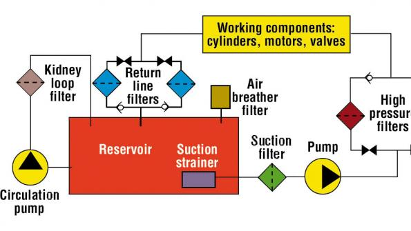

    The ultimate filtration system cleans fluid before it enters the pump, after it leaves the pump, before it returns to the reservoir, and while it is in the reservoir. In reality, designers must decide which filters are essential, and which ones they can afford to leave out.
    So when specifying the ideal hydraulic filtration circuit just isn’t an option, determining which filters will do the greatest good for an application (and for the least amount of money) becomes the task at hand. Following are some general cost-versus-benefit guidelines to help you make this determination.
    Breather filters are placed on hydraulic reservoirs to prevent atmospheric contamination from entering. Air enters the reservoir whenever the fluid level drops. This occurs during normal cycling of the machine, and when fluid cools down during idle periods. Breathers are designed to stop particles larger than 3 µm from entering the system. This is a sensible, affordable solution for any hydraulic system, but by all means cannot be the only filter on a hydraulic system.
    Breather filters probably offer a greater benefit per dollar than any other hydraulic filtration technique. If a reservoir sealed from the atmosphere is not practical, filter breathers should be specified for the overwhelming majority of applications.
    *Cost: $10 to $15          Benefit: high
    Suction strainers, or sump-type filters, are typically found in the hydraulic fluid reservoir. Their only real use is to keep cigarette butts, moths, nuts and bolts, and the like out of the pump. These large size contaminants easily can be eliminated instead by keeping the reservoir sealed and by using a filler-breather and return-line filter. However, no matter how unlikely it may seem that large objects such as these could find their way into a hydraulic reservoir, the potential does exist. So the low cost of a suction strainer could prevent extensive damage to an expensive hydraulic pump (not to mention the cost of downtime).
    *Cost: $10 to $15          Benefit: medium
    Suction filters, normally placed between the reservoir and the pump, are designed to remove particles sized from 5 to 150 µm. They are easier to service and less expensive than many other types of filters. However, to prevent restricting the pump’s suction line (which could cause cavitation), they tend to be substantially larger than similar return or pressure filters with the same flow rating.

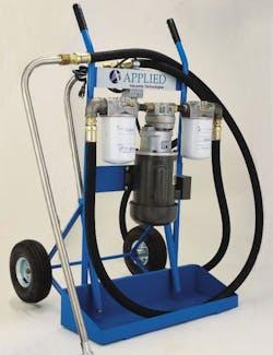

    Off-line filters, sometimes referred to as kidney loops, can achieve very fine filtration by maintaining steady-state flow that can filter fluid whether the main hydraulic system is running or not. (Kidney-loop circuits often contain a heat exchanger to keep hydraulic fluid within an optimum temperature range.) The entire hydraulic system can keep operating while the kidney loop filter is being serviced, or the kidney loop can clean the fluid in the reservoir while the hydraulic system is shut down.
    A kidney loop draws fluid from the reservoir, pumps it through its low-pressure filters, and returns it to the reservoir. Filter elements in a kidney loop are easy to reach, so they are more likely to be maintained than filters placed in hard-to-reach areas of the machine. Kidney-loop filters can either be integrated into the main hydraulic reservoir, or they can be incorporated into a mobile filter cart for servicing many hydraulic systems.
    This type of filtration presents opportunities for creative and economical application. For example, a kidney loop running all night can remove an enormous amount of contamination from the reservoir, which will extend the life of all the filters in the hydraulic circuit. Or a filter cart can clean fluid overnight in one system, be moved to another machine to filter its fluid all day, then moved to a third machine for overnight filtration.
    Unfortunately, kidney loop filters do not directly protect components. Their main function is to thoroughly clean the hydraulic fluid. Also, most filter carts require an electric or air motor to drive their circulating pump, so they can be used only where an external source of power is nearby.
    *Cost: $300 to $1500   Benefit: high

    Low-pressure, spin-on filters are easy to maintain, making them a wise choice for return lines and charge pump circuits. A filtered charge pump circuit ensures that clean fluid is delivered to the main pump while preventing potential for cavitation that can occur with suction filters.
    Return line filters usually have low-pressure housings, which are less expensive than their high-pressure counterparts. Return-line filters collect contaminants from the oil as it returns to the reservoir. Much like the kidney loop, return-line filters are versatile. They can be positioned almost anywhere within the return line circuit, either mounted inline or built into the reservoir.

    High-pressure filters, sometimes called last-chance filters, clean the fluid delivered by the pump. This protects expensive downstream components, such as servovalves and actuators. High-pressure filters offer protection from catastrophic pump failure and are a worthwhile investment for high-performance systems. They find wide application in aircraft, paper and steel mills, and injection molding and die-casting machines.
    One disadvantage of high pressure filters is, ironically, the high pressure. Housings for these filters must withstand pressures of 6000 psi or higher, so they can be heavy and difficult to handle — as anyone who has ever tried to change a slippery, 200-lb cast-iron filter can attest. Unless a duplex configuration is used and strict safety practices followed, the entire hydraulic system must be shut down to service a high-pressure filter.
    A filter cart allows several machines to share the benefits of off-line filtration.
    *Cost: $200 to $2500    Benefit: high
