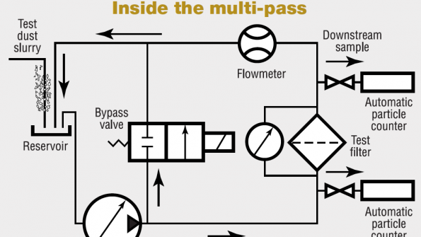

The multi-pass test
During the multi-pass test, a controlled rate of contaminant is injected into the filter test system, while online particle counts are continuously taken from fluid samples both upstream and downstream of the test filter.
The contaminant specified is ISO Medium Test Dust, an irregularly shaped, silica-based material, with a particle size ranging from sub-micrometer to about 80 μm. The fluid is MIL-H-5606 aircraft hydraulic fluid, with an anti-static additive to control fluid conductivity. Contaminant is injected at a high rate, causing the filter to become plugged, after which the test terminates (typically in 0.5 to 2 hrs). The filter is tested at its rated flow, which is maintained constant throughout the test.
The measure of the filter’s ability to remove contaminant is its filtration ratio, also called the beta (b) ratio. This is defined as the number of particles of a specified size upstream of the filter relative to the number of particles of the same size downstream of the filter. The multi-pass test also rates a filter on its contaminant- holding capacity (how much it can hold prior to reaching terminal differential pressure).
Limitations — Although multipass has improved on earlier nominal methods, its deficiencies preclude it from truly representing a filter’s performance during service in the field, especially under variable flow and pressure operating conditions. The following differences between laboratory and actual service conditions explain why performance during the multi-pass test might surpass actual performance during operation:
● The multi-pass test is conducted under steady-state conditions. Practical fluid system operation is rarely that controlled or stable, and variable flow is integral to system operation.
● Instead of the allotted test time being equivalent to the duration of a filter’s actual service life — say, three to 12 months — the test is conducted in only a few hours. Unrepresentative contaminant concentrations (1,000- to 10,000-fold higher than actual) are used for the test.
● ISO MTD is used in the standard industrial multi-pass test. It has a well-controlled particle size distribution, but it is not equivalent to the contaminant in the actual operating system.
● The test fluid, with its low 15-cSt viscosity, is not representative of the fluid used in the operation of most industrial fluid power systems. In addition, an anti-static additive is not used during actual service.
● The filter element is not exposed to cold start-up conditions or vibration during testing. Both of these can be expected in many actual applications.
