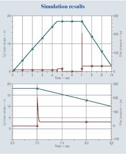

To illustrate, consider a common sweep circuit used on a trash collection truck. HyPneu simulation software from BarDyne Inc. (www.bardyne.com) simulates the circuit, Figure 2. The circuit contains two hydraulic cylinders, each with a 7-in. bore and 18-in. stroke. The circuit is driven by a fixed-displacement, 60-gpm pump and contains a return filter with a pressure drop of 16 psid at 80 gpm.
Step commands cause the directional valve to shift, thereby causing the cylinders to extend for first 5 sec, hold for 2 sec, then retract. The filter was modeled as an orifice with a flow coefficient of 20 gpm/psid. A higher flow coefficient indicates less resistance to flow. Naturally, then, flow coefficient will decrease as the filter collects dirt.
Many actions were taken to simplify this example, such as neglecting the hose and tubing in the circuit. The amount of hose, tubing, and the ratio between the two can amplify or suppress pressure and flow transient waves. Because hose is more compliant than metal tubing, hose tends to damp pressure transients. However, if disturbances occur at its natural frequency, the hose assembly can create transients. Also, operating parameters vary from truck to truck, so the simulation was conducted only to illustrate system spikes.
The results of the cylinder position and pressure upstream of the filter are shown in Figure 3. When the cylinder begins to retract, an instantaneous flow of 287.25 gpm occurs with an upstream pressure of 206 psi. The results of this simulation are instructive, but many other factors can change the results drastically.

Figure 3. Simulation results for pressure and cylinder position plotted against time, top, show a pressure spike generated when the cylinder begins retracting, at 7 sec. A closeup of the spike, bottom, reveals that the spike lasts less than 0.1 sec, yet has a magnitude of more than 200 psi.
For example, ISO 46 oil, which is typically used in the packers, has a viscosity of 220 SUS at 100° F. At 30° F, however, the viscosity becomes 2400 SUS. The pressure drop across the filter element increases with the viscosity of the oil, so the flow coefficient decreases accordingly. However, the flow coefficient can be increased by placing the filter element within the reservoir.
It follows that a reduction in differential pressure at a given flow rate increases the flow coefficient, which, in turn, reduces the amount of energy that is trapped by the restriction. By reducing flow restrictions, the tank filter reduces the potential-failures due to transients.
In this system, the transients caused by a disturbance are quickly dissipated, but the potential problems they cause are not. The filter element and housing must be sized to accommodate these transients. Failure to do so can result in filter and system failure. For example, if the pressure seen by the filter housing is taken to be the pressure caused by the flow alone, it will be inadequately sized. Without taking into account the transient spikes, it might be feasible to use a filter with a fatigue strength of 150 psid. This undersized filter presents a potential failure, since pressures of greater than 200 are routinely seen. Furthermore, the filter element must be able to withstand a larger differential pressure caused by the increased flow.
