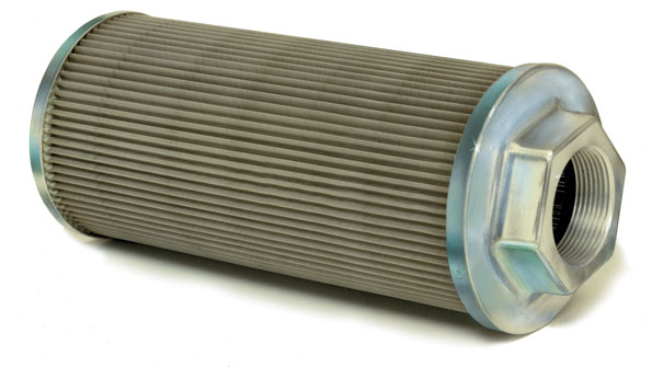

Sump strainers are placed in the hydraulic tank below the minimum fluid level to keep large contaminants from being ingested by the pump. This strainer is available with a built-in bypass relief valve to prevent staving the pump during startup if the strainer becomes clogged.

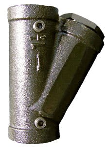

Y configurations make convenient strainers because it’s easy to remove the element for cleaning or replacement, and without having to drain the reservoir.
