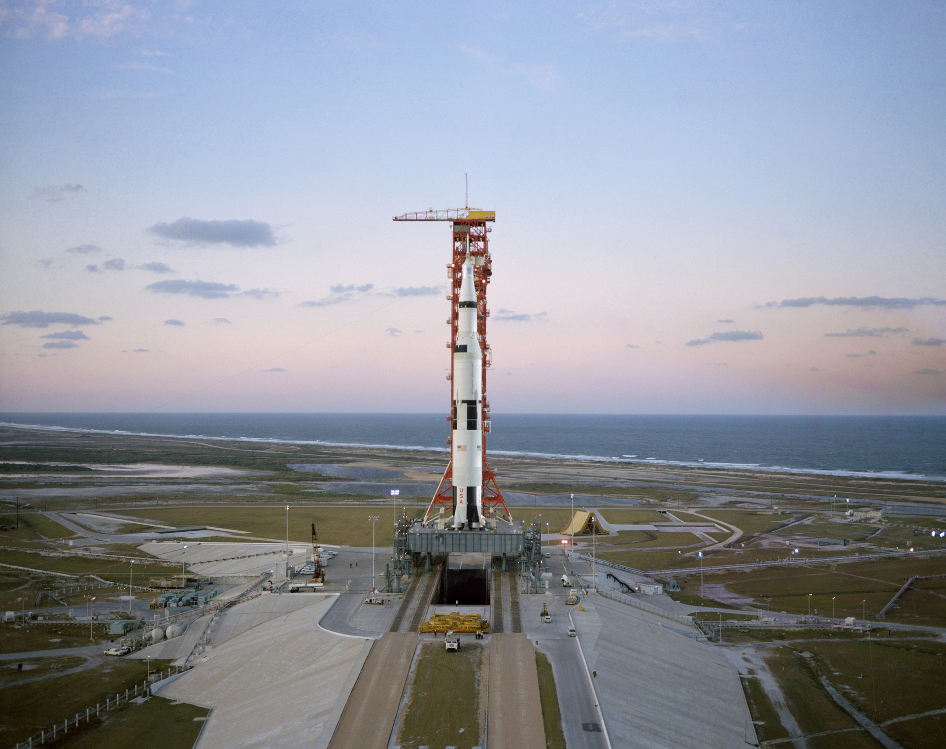

Two fuels will actuate the hydraulic controls that will gimbal the engines of the Saturn V. Propellant fuel will power the system in flight. Ramjet fuel will check out the system on the ground and start the engines.
This article was originally published in the December 1963 issue of Hydraulics & Pneumatics.
The S-IC stage will be the first-stage booster of the advanced Saturn V space vehicle, which will help launch the Apollo rocket on its way to the moon. It has five F-1 engines, hydraulically controlled, each with a thrust of 1.5 million lb.
The fluid-power system currently being designed for the Saturn booster will perform two functions. It will supply ground and in-flight hydraulic power to gimbal the four outboard engines and ground hydraulic power to start all five engines.
During flight, the system will use 2000-psi, RP-1 fuel from the F-1 engine turbopump. For checkout and engine starting, it will use RJ-1 ramjet fuel supplied from a ground source.
