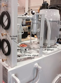

1. A high-pressure filter with visual and electrical indicator is mounted directly downstream of a pump in the hydraulic system’s HPU. The hydraulic system actuates a weir, or gate, in a dam that lets municipal workers control water level in a small lake.

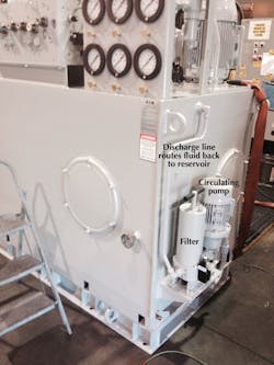

2. An off-line (kidney-loop) filter assembly uses an electric motor and centrifugal pump to circulate oil from a hydraulic system’s main reservoir, through a low-pressure filter, and back to the reservoir.

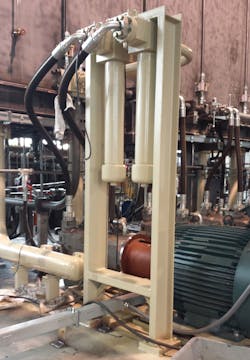

3. A hydraulic system powering an industrial press uses two high-pressure filters downstream of the system’s main hydraulic pumps to protect valves, actuators, and other critical components from contamination.

Designers should always avoid specifying filters purely based on maximum published flow rates. Maximum flow rates are purely a measure of what the filter can handle without damage to the element. They are most definitely not the flow rates at which the filter can be expected to deliver maximum cost-effective performance.
Other factors, such as fluid viscosity changes and cold-start conditions, also impact filter performance and life. Eaton recommends that hydraulics filters be sized for twice the desired maximum flow rate. Doing so will optimize filtration performance, decrease downtime, and reduce a machine’s total cost of ownership.
We also suggest that filters should be equipped with differential pressure gauges or switches. Comparing the inlet pressure to the outlet pressure gives a good indication of how much dirt is in a filter element. Switch-type units can be hard-wired to a warning light, audible alarm, or other device. This will proactively notify maintenance personnel of an approaching end-of-life condition before the filter goes into bypass mode.

4. A low-pressure kidney-loop circuit can provide continuous filtration of fluid, even when the hydraulic system is not operating. This method often is used in applications with an extremely high potential for contamination ingression. Operating the circuit during an off shift can clean the fluid to near-pristine condition for the start of the next work shift.

OEMs seeking an even more cost-effective approach can usually design out most of the active loop filtration system entirely. This is done by designing in and off-line (kidney-loop) filtration circuit. This is a stationary system that continuously filters fluid in the reservoir. This approach has several advantages.
  • A kidney loop does not need to operate at high pressure and can, therefore, use less-expensive filters.
  • It can be shut down for filter maintenance with no impact on system operation.
  • It usually can achieve efficient laminar flow to maximize filter performance.
  • It can easily incorporate a low-pressure oil cooler to moderate fluid temperature.
  • A kidney loop does not require exceptionally fine filtration because it continuously cleans the fluid. Typical systems use a 25-µm element on the pressure side and a 10-µm element on the return while maintaining specified fluid cleanliness levels.
