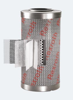

For example, an application requiring a high-performance element will often have a Beta ratio exceeding 1,000, where 1,000 particles enter the filter but only one particle makes it out. Element performance in this scenario would be expressed in terms of a 99.9% efficiency. A reputable filter manufacturer will have documentation defining their element performance by the element’s pore-size rating. But having a strong understanding of the application’s performance requirements empowers you to enter the filter sizing and search stage equipped for success.
