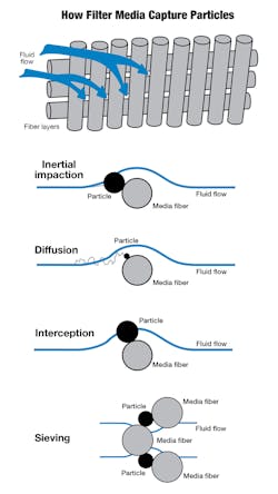

Filter media can capture particles four ways, and usually relies on more than one.
Inertia affects large, heavy particles suspended in the flow stream. These particles are heavier than the fluid surrounding them, so as the fluid changes direction to enter the fiber space, the particle continues in a straight line and collides with the media fibers, where it is trapped and held.
Diffusion works on the smallest particles, which are not held in place by the viscous fluid, so they diffuse within the flow stream. As the particles traverse the flow stream, they collide with the fiber and accumulate.
This drawing illustrates how solid contaminants are captured by filter media. At the top, contaminated fluid flows into the media mat. As different types and size encounter media fibers, they are captured by inertial impaction, diffusion, interception, sieving, or any combination of these. (Courtesy: Donaldson Co.)
Interception works on particles that are not quite large enough to have inertia but not small enough to diffuse within the flow stream. These mid-sized particles follow the flow stream as it bends through the fiber spaces and are captured (intercepted) when they contact a fiber.
Sieving is the most common mechanism in hydraulic filtration and occurs when the particle is too large to pass through the spaces between fibers.
