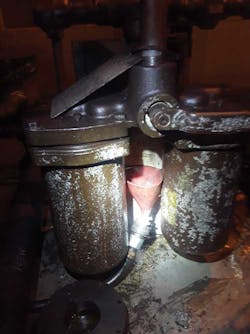

The TestOil analysts are regularly out in the field and are able to observe, firsthand, the following contamination and probable causes:
  • Unsealed hatches and ports. Many hatches, while fastened, are not well sealed.
  • Leaking seals on shafts. This can be a prime source for contamination from process fluids and water as well as dust and dirt.
  • Unfiltered oil additions. This is through additions using contaminated containers or through contaminated oil from poor storage practices.
  • Incompatible oil additions. The addition of the wrong lubricant for the system.
  • Water ingression. This can enter from the environment and/or during machine wash down.
  • Solid contaminants. These invade through open hatches and poor breathers.

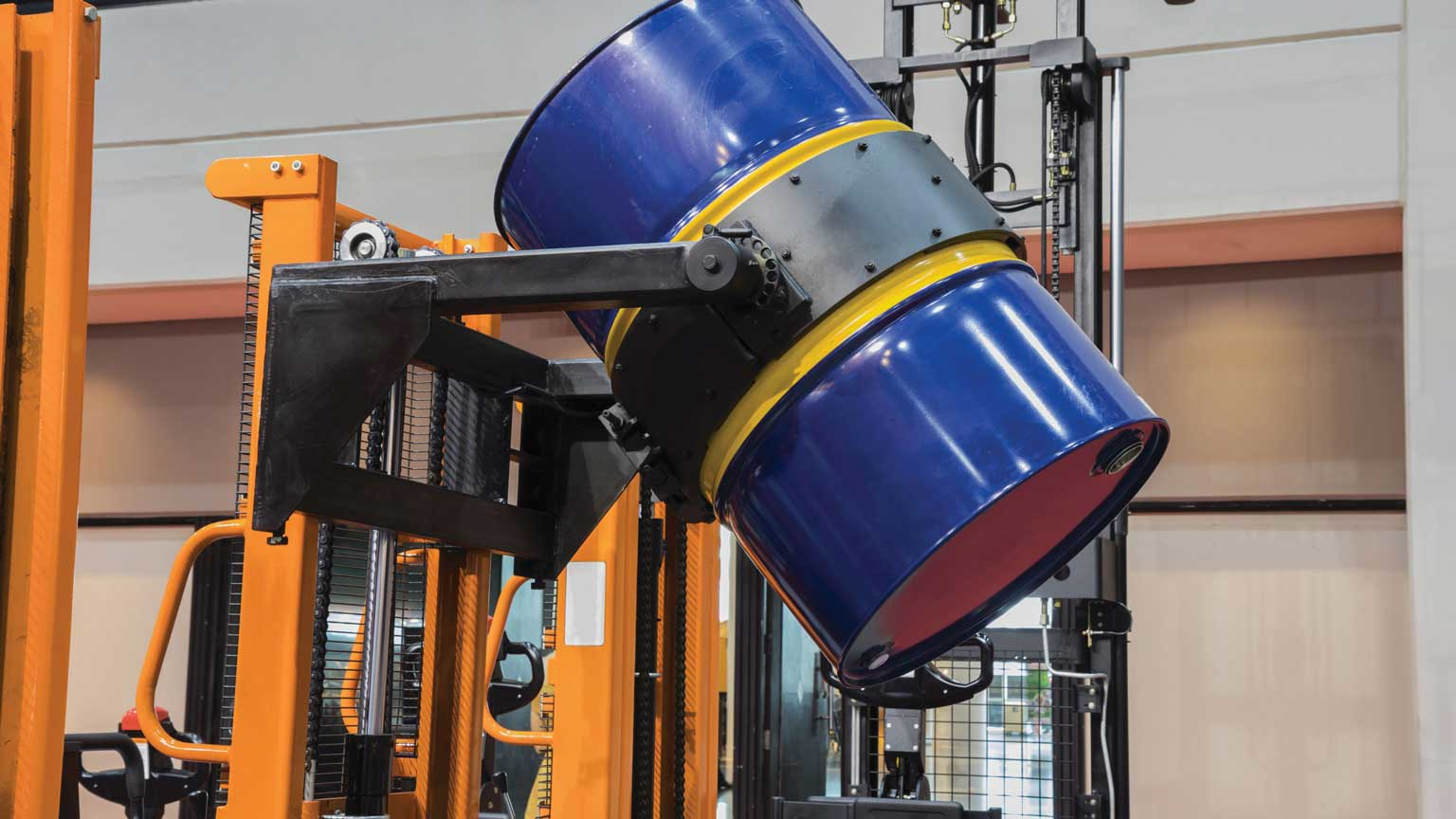

“Most common issues are related to starting with ‘dirty oil,’ meaning the product delivered to them is out of spec for their equipment before they even receive it,” Benz says. “Many of the specs ask for a cleanliness code that is cleaner than standard new delivered oil. The environment where the product is kept would be the second most common issue; many times the storage for the product and the environment around the storage is not maintained in a way to reduce contaminants.”
Benz cites, as an example, a tote of oil in a lumber mill. The tote may be kept in an area where sawdust is pervasive in the air and builds up on the storage container. “Without proper storage filtration and a plan to keep the environment clean, it is very difficult to keep the integrity of the product in line,” he says.
A final issue, Benz mentions, is transport from storage to the equipment. “It must be done in a way that does not contaminate the product further,” he says.

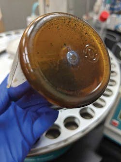

Identifying Contamination
Some types of contamination can be identified visually or audibly—especially if the contamination is pervasive. “Increased heat, vibration and noise are all external clues that a lubrication problem may exist,” TestOil analysts say. “Unfortunately, at this point, equipment failure has already begun. Leaking seals also may be an indication of contamination, but other factors such as equipment misalignment may also cause seal failure. There may be water present—if sampling from the drain, water will exit before the oil—and there may be foam present, which would indicate contamination or some mechanical issue with the machine. In the sample itself, visual indications of contamination would be a clear separation in the sample bottle, it would show a different color than other samples, the lubricant would appear thinner or thicker than expected, and there may be formation of sludge.”
When there is an incident and suspected contamination as a result, the oil should be sent to a lab immediately. According to TestOil analysts, “Whenever an event occurs that may have contaminated the oil—such as increased heat, vibration and noise, possible water or process fluid contamination or incorrect lubricant additions—the fluid needs to be tested.”
According to TestOil analysts, the following tests would typically be conducted in the lab to determine:
  • If the gear oil has been contaminated: depending on the type and operating conditions of the gearing: viscosity, Fourier-transform infrared spectroscopy (FTIR), particle count, acid number, ferrous wear, analytical ferrography and water concentration.
  • How extensive the contamination is: Karl Fischer titration, particle count, analytical ferrography.
  • The material makeup of the contamination (assuming solid contamination): analytical ferrography and material identification analysis.
Regular lab testing should be able to identify gradual contamination before it becomes a problem.
