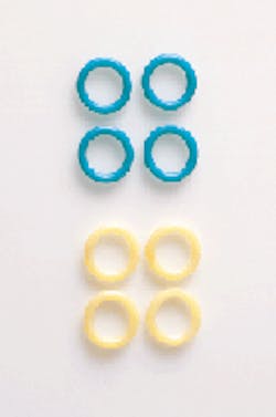

From left, green proprietary P4301A90 seals and yellow conventional urethane seals as manufactured; after 1493 hours of exposure to 212° F water; and after 1493 hours of exposure to steam.

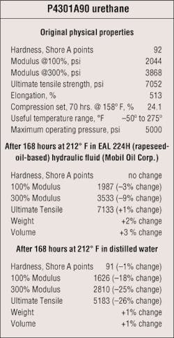

In response to this issue, we developed a proprietary high-grade urethane - identified as P4301A90 - which, due to its unique chemical composition, resists hydrolysis while maintaining excellent physical properties at operating temperatures as high as 212° F.
As seen from the test results listed in the table, P4301A90 retains as much as 74% of its original tensile strength in water and is virtually unaffected in pure rapeseed oil. Volume swell is held to a minimum, and there is a negligible change in hardness in both types of media. This indicates that P4301A90 seals may continue to operate very near to their original capability when exposed to both water and rapeseed oil.
