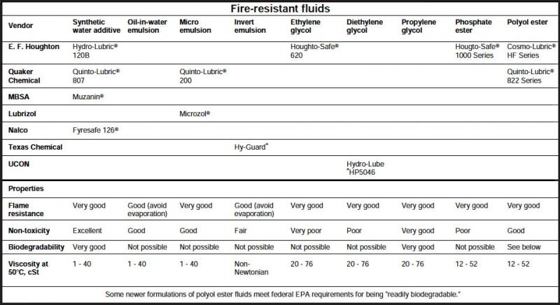

Fire-resistant fluids
The overwhelming majority of hydraulic components and systems are designed to use oil-based hydraulic fluids. No wonder; these fluids rarely present significant operating, safety, or maintenance problems. Unfortunately, there are circumstances where using oil-based fluid should be avoided. One common fluid power application is in an environment with potential ignition sources - an open flame, sparks, or hot metal. In these environments, a leak spraying from a high-pressure hydraulic system could cause a serious fire and result in major property damage, personnel injury, or even death.
Even though most oil-based hydraulic fluids have relatively high flash/fire points (>300° F), small leaks in a high-pressure system can produce a finely atomized spray that can travel significant distances. If an ignition source is encountered, complete ignition of the spray envelope can occur. The alternative is to use a hydraulic fluid that eliminates or significantly reduces this hazard: any of several fire-resistant hydraulic fluids (FRHFs).

Water glycol and invert emulsion constitute the major fluid types of water-containing products. Water glycol is a true solution of a glycol (such as ethylene glycol) in water, along with a variety of additives to impart viscosity, corrosion protection, and anti-wear properties. A shear-stable thickener, which has improved over the years, represents the novel technology aspect of the fluid. Water glycol contains approximately 40% water. Despite a number of drawbacks, water glycol is the dominant FRHF on the market today and is used in a wide variety of applications.
An invert emulsion also contains approximately 40% water but is a stable emulsion of water dispersed in oil. The outer phase, oil, represents the wetting surface; the inner phase, water, provides the fire retardant-element. Oil-soluble additives provide anti-wear properties, corrosion protection, and emulsion stability. Inverts, at one time, were commonly used but are losing favor in industry today.
Synthetic fluids initially were represented by a class of chemical compounds known as phosphate esters, which are reaction products between phosphoric acid and aromatic ring-structure alcohols. These fluids are extremely fire resistant and have widespread industrial use, as well as military and aircraft service. However, their popularity has declined because of environmental, cost, and compatibility factors.
The other type of synthetic fluids in use are synthetic hydrocarbons, more specifically, polyol esters. These fluids are the reaction products between long-chain fatty acids (derived from animal and vegetable fats) and synthesized organic alcohols. These products contain additives to impart anti-wear properties, corrosion protection, and viscosity modification. Fire resistance results from a combination of high thermal properties and physical characteristics. This is the most recent category of FRHFs and has gained widespread and growing use.
What is fire resistance?
The term "fire resistant" often is misunderstood or interpreted to be overly inclusive; it seems appropriate to standardize the terminology and review the accepted test methods for judging the fire resistance of a given fluid. First, there is no single property or test of a fluid, such as flash/fire point, auto ignition temperature (AIT), etc. that will quantitatively rate its relative fire resistance. This has led to a "simulated incident" approach in which tests are designed to replicate a worst-case scenario in typical applications where fluid power is used near a potential fire hazard. Fluids generally pass or fail these tests, and those that pass are incorporated into an Approval Guide or List of Qualified Fluids.
In the United States, two test protocols have evolved and are generally regarded as benchmarks in the industry. One was developed by Factory Mutual Research Corporation (FMRC). Their original intent was to use the test results in the risk-assessment programs of those insurance companies under the Factory Mutual System umbrella. The test has since become the chief qualification for commercial companies using FRHFs; all fluid suppliers submit products seeking "FMRC Approval." The FMRC Approval Guide lists over 300 FRHFs from approximately 50 suppliers. Factory Mutual's program is now global in scope.
FMRC addresses the definition of FRHF in the following excerpt in their introduction to the hydraulic fluids sections of their Approval Guide: Less flammable hydraulic fluids approved and listed here have been tested to evaluate fire hazard only. All presently available fluids will burn under certain conditions. In each case the fire hazard has been reduced to an acceptable degree, meeting the Approval Standards of FMRC; other fluid properties are not investigated.
This paragraph accurately puts the intent of FRHFs into the proper perspective. They are not fireproof but, rather, they significantly reduce the potential hazard associated with oil-based products. In the FMRC tests, the fluid is conditioned to 140°F, pressurized to 1,000 psi in a steel cylinder, and discharged through an oil burner-type nozzle. The spray generated is intended to simulate a high-pressure hydraulic system leak. A gas flame is passed through (not retained in) the spray envelope at two distances downstream of the nozzle. There may be local burning at the point of flame entry, and the pass criteria dictate that any flame must self-extinguish when the ignition source is removed; no flame may propagate back to the nozzle. This process is repeated 20 times, and the burn duration timed. Any burn duration over 5 sec is considered a fail.
A second test uses the same spray directed at an inclined metal channel heated to 1,300°F. In this test, the spray is continuous for 60 sec. The criteria are:
