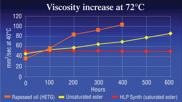

Biofluids can be broken down into four major classifications: HEPG, HETG, HEPR and HEES. HEPG fluids, or polyglycols, may be water-based but are not miscible with other hydraulic fluids. They are often incompatible with some seal materials. HETG fluids are plant or animal based and highly biodegradable. However, they generally cannot tolerate temperatures above 160°F for more than a few hundred hours. HEPR fluids, or polyalphaolefins, have good hydrolytic stability and biodegradability but may lose their viscosity as they run through a hydraulic system over time, see Figure 1.
Figure 1: This graph plots viscosity of oils, showing how in some fluids the viscosity changes over time at higher temperatures, whereas Panolin HLP Synth remains consistent.
HEES fluids, or synthetic esters, have good biodegradability. However, the wide variety of HEES products can perform drastically differently, depending on what type of HEES it is and its base composition. Unfortunately, HEES fluids are often generalized into one major category despite major differences in performance and longevity within the HEES class of products.
Saturated vs. Unsaturated Synthetic Ester
Esters are formed by condensing, or combining, an acid with an alcohol, a process called esterification. Just as not all fluids are created equal, neither are all synthetic fluids. All synthetic ester products can be broken into two categories—saturated and unsaturated. The saturation of a fluid is based on the chemical bonding within the fluid itself.
Oxidation, or aging of a fluid, is caused when a fluid reacts with oxygen. The result is extreme thickening and gumming of the fluid, along with deposits and shellac, which lead to major catastrophic system failures. Chemically speaking, an unsaturated ester has many open bonds that react with oxygen and cause the fluid to age more rapidly. Saturated esters, on the other hand, have significantly fewer open bonds, so they do not oxidize rapidly and will last much longer when subjected to  high temperatures, Figure 1.
So how can you tell the difference? The easiest way to tell the difference is to ask the fluid manufacturer for the iodine number. This number identifies the number of open bonds available in a fluid. The higher the Iodine number, the greater the number of bonds that can interact and oxidize. Generally speaking, saturated synthetic ester products have an iodine number of less than 15.
