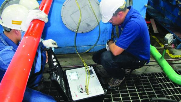

A fluid lab in a suitcase contains multiple instruments to assess the condition of hydrualic fluid, making it easy to maintain condition monitoring practices.

A laboratory in a suitcase
The heart of any condition-based maintenance program is a “laboratory-in a-suitcase,” which is used to determine fluid condition in real-time in the field. One example is the OCM 01 Condition Monitoring System from Eaton’s Internormen product line. It’s flexible enough to work in suction mode, pressure mode, or for handling traditional bottle samples. This compact machine can measure:
• contamination classes according to ISO 4406:99, SAE AS 4059, NAS 1638 protocols,
• dynamic viscosity in MPa,
• temperature in °C and °F,
• percentage of water saturation,
• theoretical absolute water content in ppm when applicable, and
• relative dielectric strength.
Users get instant readings of particulate contamination and fluid ageing with a single measurement using calibrated in-line sensors. The system has a color LCD screen and software to guide operators through the calibration and test procedure. It also has integral data storage capabilities, is able to write to USB flash drives, and can communicate with other customer systems via Labview-based software and an RS 232 interface.
The system is intended to document the condition of a new system, a system that has been opened to the atmosphere for maintenance, or immediately after fluid replacement. Doing so provides a baseline for future readings. The system should be periodically re-tested according to a schedule based on operating experience and the cleanliness recommendations of component manufacturers.
