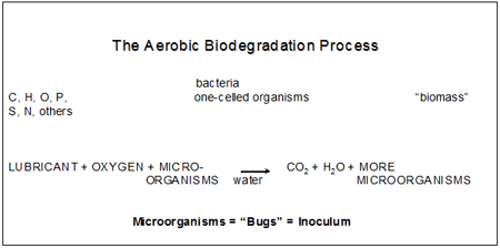

There are increasing regulatory pressures from the EPA, Coast Guard, and other environmental organizations. While small releases will not result in a Resource Conservation and Recovery Act (RCRA) clean up, large spills will. All petroleum hydraulic fluid spills are “reportable events.” These events involve a great deal of clean-up cost, administrative procedures, and punitive fines that can range from tens of thousands to hundreds of thousands of dollars.
Figure 1. Lubricants, microorganisms, and oxygen all play a critical role in the process of aerobic biodegradation.
While spilling large quantities of biodegradable hydraulic fluid is still considered under RCRA to be a reportable event, agencies are required to evaluate “bio-based oils” differently than petroleum-based oils. As awareness of biodegradable fluid increases, state and federal agencies are becoming more lenient regarding fines and clean-up costs. In fact, there are several case studies of equipment releasing several hundred gallons of vegetable-based hydraulic fluid into environmentally sensitive areas with no fines and minimal clean-up expense. In most instances, the operator was able to continue working while clean-up efforts were underway. Since the fluids were biodegradable and non-toxic, there was no long-term negative effect to the ecosystem.
