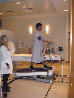

If a treadmill controlled by hydraulics is unusual, one powered by water must be over the top.
A special treadmill, designed to operate in a room with an MRI machined, relies on water hydraulics for its power.

Watch a video of the treadmill setup below:

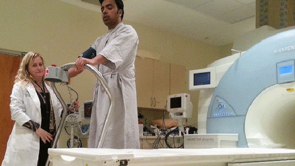

Eric Foster is COO of EXCMR Inc., Columbus, the company that designs and manufactures the water hydraulic treadmill. He explains why the treadmill must be so close to the MRI machine:
Heart disease affects more than 70 million Americans and is the leading cause of death in the United States. Two-thirds of these deaths occur without detection of the disease. Treadmill exercise stress testing, combined with cardiac imaging, has become the leading method of detection and treatment of heart disease. In these exams, images of the heart are obtained immediately following a treadmill stress test and compared with baseline images of the heart at rest. This lets doctors observe any abnormalities that develop as the heart demands more blood during physical stress.
These exams are currently performed with either nuclear or ultrasound imaging. Both suffer from technical limitations, and nuclear imaging involves significant radiation exposure. Magnetic Resonance Imaging (MRI) can provide a complete cardiac imaging evaluation that is superior to existing techniques.  However, the combination of exercise stress with MRI has not previously been feasible because traditional treadmills cannot be safely placed in the same room as the MRI machine.
Imaging must begin immediately after exercise (preferably, within 30 sec) because stress-induced cardiac abnormalities dissipate rapidly upon termination of exercise. Therefore, images cannot be acquired quickly enough if the treadmill is located remotely from the imaging system.
Furthermore, requiring the patient to walk any distance immediately following maximal exercise may produce dizziness and risk of falling even in relatively healthy patients. EXCMR’s totally MRI-compatible treadmill solves these problems by placing the treadmill in the MRI suite, minimizing the time between end of exercise and imaging to maximize safety as well as accuracy of the test.
