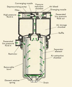

Theory of operation
This air–oil separator operates on the principle of lowering the pressure (to a desired vacuum) in a chamber containing small quantities of hydraulic fluid continually bypassed from a pressurized dynamic system. The gases thus released from the fluid are collected and prevented from being returned to the system. The gases are stored for removal at convenient intervals when the hydraulic system is at rest.
Wire mesh screen separates bubbles
Initial attempts at actually constructing the air-oil separator involved using a 10-micron (nominal) wire mesh filter screen as a barrier because of its ability to resist the passage of air. This resistance is demonstrated by the familiar bubble test used on filter elements wherein the element does not pass an air bubble until the pressure differential is at least 9 inches of water. This premise was correct in that air did not pass through a 10-micron filter screen as long as the air was in the form of small bubbles. In other words, free air did not pass through the filter screen when the air content of the fluid was well above the saturation point.

Aspirator vacuums air from fluid
Unfortunately, bubbles get smaller with increasing pressure. The lowest pressure in the F-104 is about 30 psig. This pressure was far too high because even at this pressure the free air bubbles would be compressed and driven through the filter screen. Total bubble removal was not possible. The next logical step was to introduce an aspirator, which would reduce the pressure in the chamber so the bubbles would expand and not penetrate the filter screen.
It was at this stage that the scheme to use a jet pump (aspirator) to lower the pressure in the separating chamber was tried. By lowering the pressure acting on the fluid, large quantities of dissolved and free air were released and the filter screen barrier was able to separate the bubbles from the fluid.

On F-104 aircraft, two separators–one for each hydraulic system–are in operation whenever the aircraft hydraulic systems are used, either in flight or on ground test stand power. Extracted air is easily bled-off during ground servicing with a  conveniently located pushbutton-operated bleed valve in each system that sequentially blocks jet pump flow and opens the air storage chamber to the atmosphere.
Sizing separator to system
An air-oil separator can be designed to fit most hydraulic system requirements by varying the volume of pressurized flow, separating chamber and filter size, and servicing frequency. The volume of separating flow and separating chamber vacuum pressure can be balanced by adjusting the size of the inlet restrictor. The jet pump should be sized according to the amount of pressurized flow that can be spared from the system and the amount of heat that the system can tolerate. (Pressure drop across the pump nozzle adds heat to the fluid.)
If an air-oil separator is considered during the early stages of system design, the separating filter can be integrated with system filtration requirements since the separator is ideally situated in a bypass loop of the system with relatively low flow rates and low return pressure.
