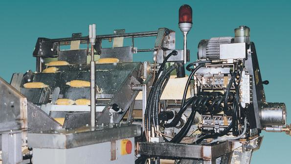

When hydraulics are used in food processing, such as this corn dekerneling machine, hydraulic fluids and lubricants must be non-toxic to prevent contaminating food from incidental contact.

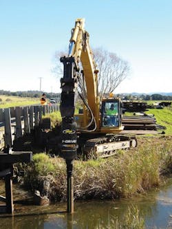

Environmentally-sensitive areas, like waterways, require hydraulic fluids that are non-toxic and bio-degradable.
