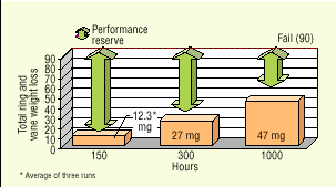

Eaton-Vickers test — The next phase involved running an extended-length Eaton-Vickers 35VQ-25 vane pump test to determine the durability of the anti-wear formulation. We ran the test at standard test conditions of 200° F, 3000 psi, 2400 rpm, and a flow rate of 38 gpm. By increasing the time limit from the standard 50 to 1000 hr, we saw progressively more amber to dark brown varnish deposits in the reservoir as the test progressed from 500 to 1000 hr.
Figure 1. Test results on the Eaton-Vickers 35VQ-25 vane pump, standard vs. extend length, show little impact on weight loss for total ring and vane wear.
The Eaton-Vickers specification calls for measuring the ring and vane loss of the pump after running for 50 hr. Our result, depicted in Figure 1, shows less than the 90 mg acceptable weight loss for total ring and vane wear. We concluded that the antiwear formulation had the durability to exceed the parameters of this test.
